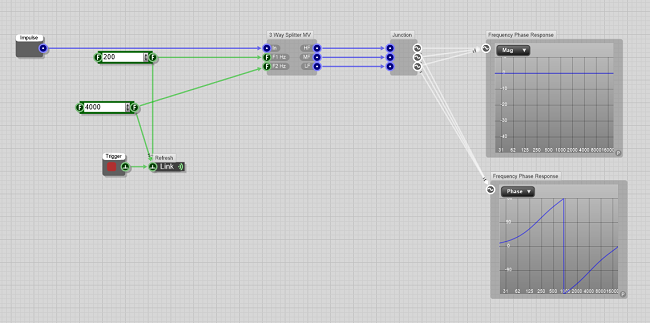

Hi,
I had started off with the tutorial as mentioned.
For the example I have a 3 band splitter (cross-over) which shows a flat frequency response, and a 'slow-climbing' phase response. (I named it MV for Martin Vicanek since this is Martin's example from the GURU, hope this is OK).
3 Band CrossOver MV 2.png (106.3 KiB) Viewed 17103 times
Can I ask why if this is a good or rather normal phase response curve?
After I better understand this, my plan is to add some example processing which will be different for each band.

Re: Multi band processing - internal latency
The combined bands phase response is that of an allpass. Some people would prefer linear phase (= same delay of all frequency components), however that is not possible with IIR filters.
