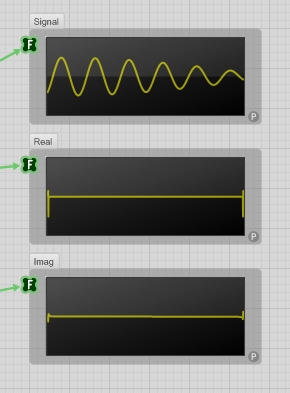

On the picture example of work of FFT. Whether it is possible to get access to every period of a signal separately? May be convolution?
- FFT_Test.jpg (61.06 KiB) Viewed 40492 times

For example, I want to make so through FFT, but standard methods don't allow to make so.
- FFT_Test_2.jpg (48.1 KiB) Viewed 40437 times

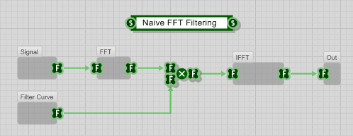

People tend to think of an FFT representation in terms of a graphic equalizer, where you can simply multiply each bin by its corresponding slider value, then simply inverse FFT the result and that's it:
That might work if your filter curve is very moderate.

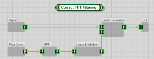

However, the correct way of doing it is based on linear convolution.:
You first IFFT your filter curve to obtain an impulse response (IR). Theen you apply a circular shift so the bulk of the IR is at the center of your frame, and apply a window function to avaid border artifacts. Then you convolve your signal with the windowed IR.
Re: FFT question
The problem is that I have no constant filter curve. It depends on a signal and changes according to it.
Re: FFT question
No problem, just keep updating your IR as you go. Use overlapp and add to avoid sudden changes.
