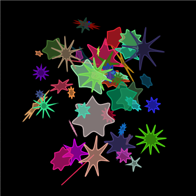

Pretty,ain't it?
Art made in FlowStone...
- and it looks even better when it's MOVING!...
DOWNLOAD:
GRAPHICS CLASSES 2_001.fsm
(29.67 KiB) Downloaded 1857 times
And there's more to it than just a pretty face, it's also set up to do a bit of analysis and stress testing of Ruby and the GDI graphics engine. And a couple of examples of new home made classes of objects that take all the sweat out of animating objects. And a few other little examples and gizmos and testers and stuff.
There's plenty more instructions and comments in the schematic and in the Ruby code.

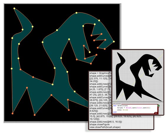

And after posting something beautiful - here's the BEAST!!!!
Shape Maker.jpg (74.38 KiB) Viewed 38513 times
GgRRRrrrr..... etc.... ..ahem....
Vector graphics for the GraphicsPath objects can look great, and scale nicely, and it's dead easy to change the colours and all that - but the sitting down with a bit of graph paper, and calculating a load of co-ordinates...BORING!
So here a very, very, early, early, proto-proto-prototype of a better way to do it - design your graphic using mousey pointy wddgets and a WYSIWYG, press a button, and it spits out the Ruby code to make the shape - which you can just cut and paste into your code (or even just 'eval' as a string.
DOWNLOAD:
Shape Maker.fsm
(7.27 KiB) Downloaded 1825 times
So far it supports shapes made of lines, wibbly-wobblly closed Curves, and shapes made up from a combination of lines and curves. You can add as many points as you want, and delete them too. Beziers should be possible too once I've got a couple of array formatting problems delat with.
As all the data is purely arrays of numbers, it will also be easy to make shape "templates" that will get safely stored in @ins and @outs without the editor connected, and saving the arrays to file is also simple.
Damn, and I have to go back to work on Monday - I was just getting into the swing of it... ;)

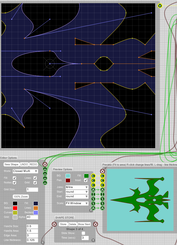

Latest version of the GraphicsPath editor now available for tinkering with - nowhere near finished yet, so apologies for the crummy user interface; but a whole load more features...
Shape Maker 009.png (138.7 KiB) Viewed 38356 times
DOWNLOAD:
Shape Maker 009.fsm
(15.76 KiB) Downloaded 1858 times
NEW...
- Bezier curves, with handle linking for when you wany smooth curves
- Better curve optimisation to allow segments of any type in any order with selectable cusps and smooth joins.
- Grid with snap
- Open shapes (i.e. lines, arrows etc.)
- Pan and Zoom on the editor window
- Undo and redo
- Improved preview with brush, pen, arrowhead etc. selection.
- Shape store module for remembering and recalling shapes (and slide-shows!)
- Much better optimisation of the output code, redundant nodes removed, lines joined better for fewer sub-paths.
- Moving the shape's position supported in the code output.
Still plenty of other new stuff to come - but I'm pretty happy with the editor. I don't really want to take that too much further as there are pther packages, like InkScape, that are much more fully featured. I've been looking at the spec's for the SVG file format - there wouldn't be total compatibility as SVG only supports beziers for curves, but Ideally I'd like to use this more as a 'clean up and optimise' tool for imported SVG files, as there are just so many useful ones already out there, and even tools to convert text etc. to SVG. If I can't get that to work, then save/load for a custom format is easy enough to include.
P.S. If you click the "slide show" box on the "SHAPE STORE" module (bottom of the schematic), you will get a mini-slide show of a handful of shapes that I made.

Well, you might just get lucky - I will be converting some of my old stuff over to FS in the coming months, including my looping effects, which just so happen to have a timeline strip similar to what you describe. Might be a while though - i got started on about three new FS projects over the Xmas break, and now I'm back at work..
