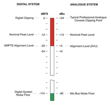

I find this article that seams really better, but not really sure if there's more to take into account or other's scale that could be true. What do you think about this ?

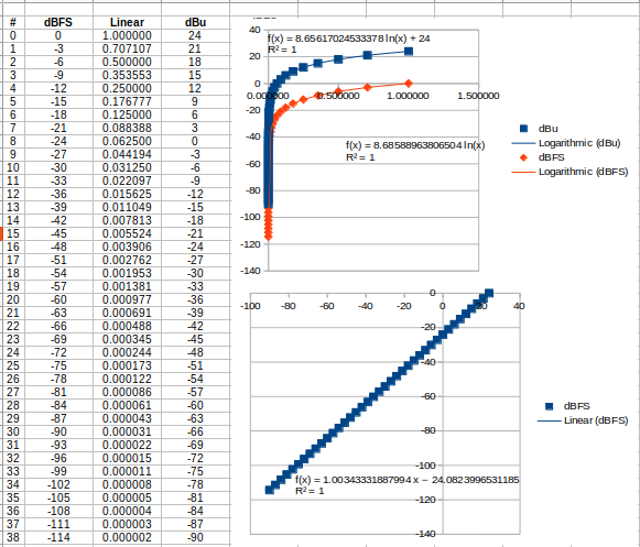

- DBDBFS.png (45.25 KiB) Viewed 80071 times

By meter you linked; x ± 24 (depending on which way you want to convert it).So i try to find a good value and a good match, how much analog DB correspond to digital DBfs..

Thanks, it confirm the -24db.
