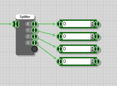

Using map as you suggested Tulamide, to spit out 0,1 integers from Ruby box will work perfect for now I think 8-)
Took a while but seems to work with my reset schematics and insane amount of selectors :D after some additional trigger blockers and "changed prims" etc to avoid potential trigger storm and unwanted triggers during knob movements.

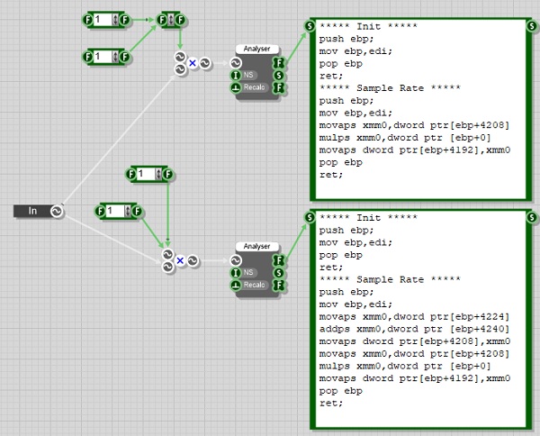

Noticed this "carry over" to poly... after working alot in green. I have to go through alot of my poly schematics or?
Edit: Phew!... luckily wasn't that many :lol:
Question... anyone know how this prim works inside or looks in Ruby?
Edit: Seems slightly different from just doing a for/while/times loop in the Ruby box. Might be a changed and/or samplehold behaviour due to having stored internal input variable, but still passing the trigger along...
