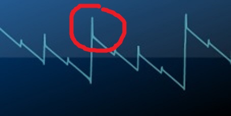

I could use some descriptive parameter naming help...
What would one call this simple subtraction removing the saw but keeping the transient (2 samples)... if it was a knob?
Contains the fundamentals of the saw... but obviously retains HF.
Any suggestions?
This parameter will be another pain in the a** to add. :? Why did I have to add so many routings... :roll:

R&R wrote:I could use some descriptive parameter naming help...
Any suggestions?
Fragmento, fragment or just "slice" maybe... 8-)

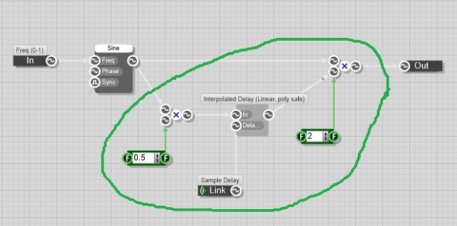

MV if you haven't tired of me completely yet ;)
But someone else might also be able to help me answer this...
Does the parts circled in green cost more or less than a single toolbox sine?
Trying to get some freebies without too much CPU cost.
But can't measure or count operations on a toolbox sine since it's wavetable I guess...
2nd_harmonic.fsm
(1.89 KiB) Downloaded 658 times

R&R wrote:MV if you haven't tired of me completely yet ;)
Hmmm...
Darn it! Looks like toolbox sine wins this round :|

Looks like Tepeix delay found here: http://www.dsprobotics.com/support/view ... 37#p237237 was quite fast... Nice job!
I didn't seem to beat using a second toolbox sine with phase offset in my particular scenario. But is seems slightly faster than MVs variant so it's really useful for the slice.
Don't know if there is a compromise or difference in their outputs (these two interpolated delays)...
