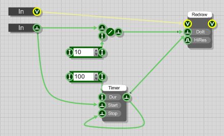

Try to use external redraw with trigger div and timer.
- Redraw Limit.jpg (21.77 KiB) Viewed 29264 times

Hi,
Thanks for the help.
Sorry to say that I had tried that - without positive results.
Notice that I had also tried this 'trigger filter':
This one really filters out the triggers (depending on @tc --> time constant) of course.
I added a trigger counter before and after this filter, and it could filter ~x10 times the fast triggers from mouse dragging.
Albeit this result, the CPU still jumps to ~50% on mouse drag ??!
