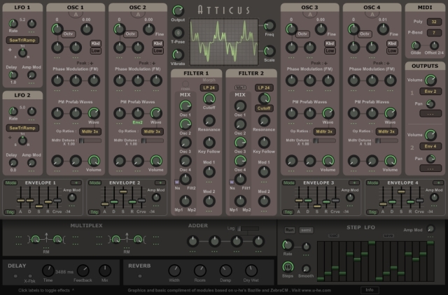

This isn't a new one or a massive re-vamp, but since it's probably the most complex and flexible little monster I've ever built, I thought I'd let everyone know that I finally got 'round to param-naming Atticus , my spin on u-he's Bazille, but hopefully a little easier on the CPU. It doesn't have all of Bazille's features and the oscs and mixer/filters are rather different, but it's still a beast!
-Four analog/digital hybrid oscillators.
-Two filters with internal mixers.
-Two VCAs.
-Two LFOs.
-sLFO.
-Four EGs.
-Two 'Multiplex's.
-CV Adder/Lag
-Reverb/Phorus
-Delay/Chorus (Chorus sucks, though)
