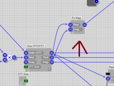

Does anybody knows how to make from mag to real and imag? It would be opposite from this?
- Untitled.jpg (47.53 KiB) Viewed 45683 times

The schematic contains both real/imag->mag/phase and mag/phase->real/imag conversion modules. Just check in the module called "components".
Note that both amplitude and phase information are needed to reconstruct the complex number properly.
