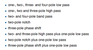

k brown wrote: maybe some help from martin v with getting a more complete and accurate set of filters for eXpando (OB Expander - did I include that in Bundle?).
What kind of filters exactly do you have in mind?
I looked into doing a small Serge some time ago, too many of the modules I couldn't quite get my head around, and info in the net was a bit sketchy. Also, I don't plan on doing any new stuff after the end of the month (my gallery's re-opening and I'll have to get back to painting full-time).
-Hello martin;
Here's the list of the Xpander's rather unusual filter states (from the Wikipedia page):
Xpander filter modes.png (37.42 KiB) Viewed 32768 times
Also, this:
https://www.gearslutz.com/board/electro ... -ques.html
And this:
http://www.doepfer.de/a1066.htm

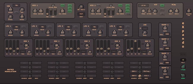

Turns out I didn't include eXpando in the Bundle, so here it is -with DAW automation compatibility.
Broadly an Oberheim Xpander emulation, but:
Filters incomplete and not very accurately emulated.
No Tracking Generators (couldn't figure out how).
Just the Voice, no splits, layers, six separate outputs etc.
https://www.dropbox.com/sh/8ymdr0rgtkvw ... Kcwga?dl=0
eXpando copy.jpg (151.37 KiB) Viewed 32710 times

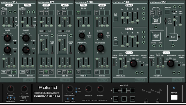

And the fix for Rolend System 101M:
https://www.dropbox.com/sh/e5p6dmccn2c9 ... kH8Ra?dl=0
Rolend System 101M copy.jpg (200.65 KiB) Viewed 32708 times
