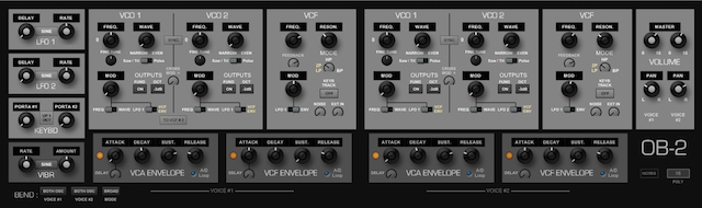

And, still on my Oberheim obsession: A Two-Voice version of the OB-1.
OB-2.zip
(1.78 MiB) Downloaded 1291 times
OB-2 copy.jpg (89.72 KiB) Viewed 30334 times

OB-2 originally uploaded with a dead Voice #2; link in that post is now to the corrected version.
