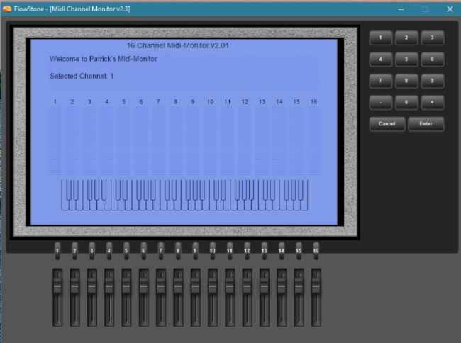

This is my first post here.
I'am new to flowstone and ruby.
I want to make a Midi-Monitor and later a controller of it.
This is wat i made till now.
Maybe some of jou have some tips?
- Midi Channel Monitor v2.31.fsm
- (86.8 KiB) Downloaded 1174 times
- Midi Channel Monitor v2.3 screenshot
- screen.jpg (86.44 KiB) Viewed 31718 times

Hi PatieThePC and welcome to the forum
This is really good, it works fine with my M-Audio Keystation 61es and I put it straight into my toolbox so thank you very much for sharing.
I renamed the keys in the Ruby module from D#, G#, A# to Eb, Ab, Bb because I'm used to that naming system.
I don't know what you had in mind originally but it might be nice to have a bar graph display for CC values; maybe a dedicated one for pitchbend and modwheel and one where you can select the CC for less common ones like aftertouch etc. Just a thought and I like it as it is!

Tnx for the info Spogg and Tulamide,
I was thinking about that ptoblem. One sulution maybe is "Let ruby remember last note and than calculate if the note go's up or down" But i'am beginner in ruby, so it wil take a while for me to figure that out.

First my excusses for my not very good english, i'am from the Netherlands so enlish is not my native language
A made a little progress on the Monitor. Now all 16 Channels are readout, and i put the ruby-code for each channel in to one ruby_module.
Now i want to try put the greens for the level_meters togeter in one mudule, maybe in ruby also.
More functions comming soon.
My goal is to make a complete Midi-Monitor/Controller of it.
New version in first-post

Hello,
I'am back again.
I've made some changes to my midi Monitor/Controller
The level sliders are working now.
I have changed the playing notes to be displayd in a piano. You can chance the display channel by
clicking on the channel-number.
Most work was at the inside. But more functions are comming sone.
Hope jou like ik. Tips are welcome
