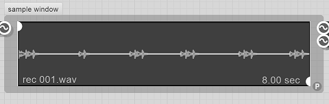

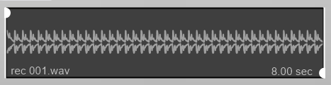

Re: how to send Midi Message
Here is the null->
original->
original->
nix wrote:Here is the null->
Thats not null
Can you post please to me that module to check "null"? So I wont use FL for tests...
it's not user friendly,
just a quick sampler mod
Yeah- something's up, it is very close though and almost cyclical
