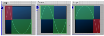

Maybe we just talked past another?
The lines enclosed in red are not sinusoidal waves (they are the "opposite", so to speak), the ones in green are.
Here is an example of a fully sinusoidal wave that is continuous on either side and in the center:
Also, I converted the project from the second answer for you to see. It is an online interactive page. Just click the link, wait for the start screen to vanish and then move the slider to see the changes. Note that it is fully sinusoidal AND continuous. Link: https://db.tt/ILkzu55c
