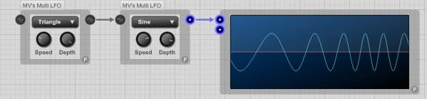

Hello, i have a theoretical question. How to create a dynamic change of frequency lfo, using lfo2.
http://rghost.ru/7PrFXKCgR/image.png

Here is a practical answer.
- ModulatedLFO.fsm
- (31.5 KiB) Downloaded 863 times

Re: Dynamic freq to lfo.
This is the only way?
You can manipulate phase offsets as well.
i try use sin( pi*2 / ( 44100.0 / control) * count) control = pseudo lfo2
If i change in real-time parametr contol, sound comes from clicks. Hmm...
