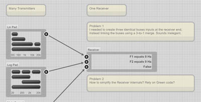

I have tried Busses in a n-to-1 scheme. I wanted to grab parameters from everywhere in the schematic. There are several controllers.
Controller_ 1 can modify a parameter, like multiplying its value by two.
Controller_2 can also modify the same parameter, like dividing its value by two.
I cant't get this thing working.
1- Merging busses in a candid way doesn't work, as such merge adds old data with new data, instead of replacing old data by new data. When dealing with strings, the add is a concatenation.
2- How can a Controller read the data on the bus, before doing his job (like multiplying the value by two), then place the updated value on the bus, without ending up into an infinite loop?
See attached .fsm and .jpg.
Any advice welcome.
Any advice welcome.

In the attached schematic I've two solutions for you. They work nearly the same, but the outer schematics have a different structures. My preferred way would be "Version TWO", because it's much cleaner and you only have one single bus line, that is running in circle.
I've commented in the schematic.
