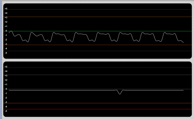

If I make an array in a ruby component
c = Array.new(64,52) # 64 elements with a value 52
and I initialisize the elements with a value of 52 and by every call of this ruby component I change 1 element.
so after 64 calls I have 64 avaraged values? No..... every time the other 63 element are again 52????
How can I get it not everytime initialisized? I have read 3 ruby books but I can find it how a one time initialising works
I try to use stage(0) but that can not work because Ruby needs to see continue that c is an array.
The green line is a value of 50 the upper white line are the actual values and the white line in the second screen
need to be 64 avaraged values of the upper screen.

You need to use instance variables. You initialize an instance variable by putting "@" at the beginning of a name (for example @variable ). Best place to do so is in the "init" method, which is called first, when the schematic is loaded.
here's an example code (note: it will not work in the form down there - you have to specify the "someIndex" and "someValue" depending on your needs):
def init
   @a=Array.new(64,52) #initializes instance variable @a, which is array of 64 integers with initial value 52
end
def event i,v
   @a[someIndex]=someValue
   output @a
end
variables wothout the "@" are local variables and they are local to each function call (they are deleted after function returns).
