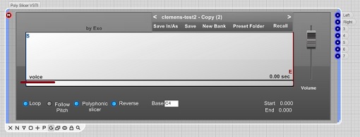

Hm, well for some reason I can't load wav, or mp3 files. Here is screenshot inside wav file module...
dll problem.jpg (84.62 KiB) Viewed 17185 times

Well here is the dll...
libFlowstoneAudioFiles.zip
(280.77 KiB) Downloaded 1170 times
Also mp3 is not supported in this dll.
I posted an mp3 to wav module HERE but I offer no support at all for that. It converts mp3 to wav but saves the created wav to the hard drive which is never deleted...

Ok, thanks. It works now. BTW, thanks for the huge work making this.. ;)
