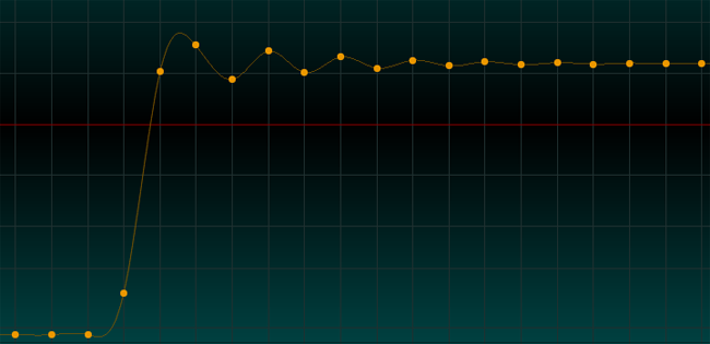

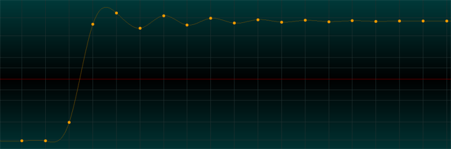

Adam contacted me before he posted this, and I couldn't really help. Although I've looked into Sylenth a bit and there are some observations:
- The decimator process doesn't add any CPU, so there is no oversampling !!!
- The sound is much cleaner than the one from FS/SM, so it is quite noticable
- The decimation rate control is smooth, so they use fractional decimation
I've attached two wave images of decimation steps from Sylenth. For me it looks like the step itself is exactly the same although the decimation rate is different in the images. Maybe it's just Band-limited step mixed in?
The major problem that the decimator has, is that the step that it introduces contains frequencies above nyquist. So any prefiltering wouldn't change anything because the step process does remove the higher frequencies that a pre filter would manipulate anyway. The step process then adds back higher frequencies that are not part of the original waveform though.

MyCo's steps look very much like miniBLEPS.
