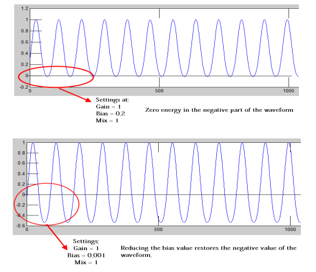

Re: Help needed for a valve gainstaging project
Hello,
I still have problems to get the gainstage right.
it shoud look like in the picture...
where is my fault? I added the schematic
thanks,
jotb
thanks,
jotb
