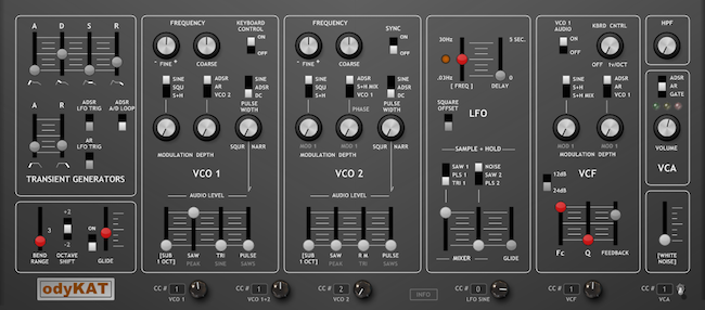

Why choose? - here's both in one plugin.
A Match Made In Heaven:
The CAT was clearly based on the Odyssey concept (there was even legal action), but it had three big things the Ody didn't - mixable waveforms in both VCOs and Sub Oscs in both, plus each mod input could select from three sources rather than Ody's two; no small things, but otherwise lacked a lot of what the Ody had: dedicated source mixer for S/H input and Lag control of S/H output, White and Pink Noise, Ring Mod, simple High Pass filter, LFO-trig of both EGs and in the later models, performance control of vibrato, and much more usable Pitch Bend. The CAT did also appeal due to it's lower price.
Many of the CAT's shortcomings were addressed by the "Factory Modifications" available as kits from Octave. These were mainly footpedal control of each VCO, both VCOs, filter cutoff, VCO Sine level (vibrato) and Volume. Another clever mod was a set of switches that allowed any combination of VCO 2's and the VCF's mods to follow the amount controls in VCO 1.
I've implemented the pedal inputs/controls as MIDI CC selectors, so one can use any combination of Mod Whl, Footpedal or whatever.
I did a mashup of these two before, but went way overboard with it and added a kitchen sink's worth of stuff that just made it a bit cluttered and intimidating; here I stuck almost entirely to things found only on the CAT SRM (with Factory Mods) and the Odyssey.
UPDATE 5/17 - Additional presets by JF Dugast - thanks!
