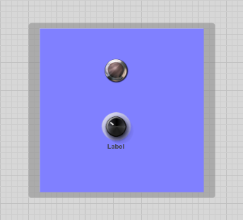

Correct me if I'm wrong, but the only option you have is to go inside the module and MANUALLY disconnect the links and then reconnect them, keeping the LIFO methodology in mind when re-linking
Try it with the example I had posted.
I've attached the schematic here.
All I get is this, regardless of the option I choose from the context pop-up (not shown):
And as you said in your post, nothing has indeed changed in this regard from V1 to V2.
- Example_on_link_precedence_000.fsm
- (21.38 KiB) Downloaded 1273 times
Re: v2 not working like v1 did! HELP!
You can only change the GUI items that are layers. Your blue background isn't a layer it is just on top, so you need to make it into a layer first in order to change it's layer position.
If everything is on the same layer, you can't bring them forwards etc. so in this case then it is just the link order that sets the order.
