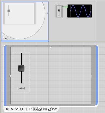

Display view?
Display view?
Why the display is not seen in the module?
How to place it on the front panel?
- The display is not seen

Re: Display view?
There's no way to connect this primitive to GUI. Instead use the "Signal Analyser" connected to a graph line.
Here's an example:
Here's an example:
Re: Display view?
I have done differently: disintegrate "Scope" and used it.
In general, I think, in the Properties should be "Show" option.
