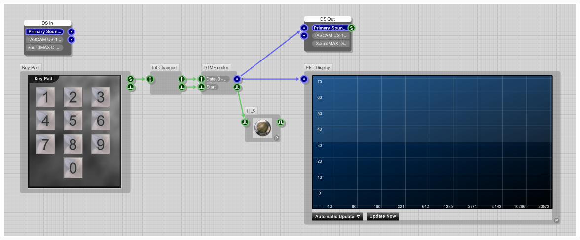

Nice project
Here is the short translation:
Here is a DTMF (Dual Tone Multi Frequency) tone generator as you find in a telephone.
Sorry just had to add a keypad:
- DTMF2.fsm
- Missing 13 fixed
- (140.25 KiB) Downloaded 1856 times

Re: DTMF generate
Yes, this code is telephone.
But me this was necessary to send commands of handle.
The right channel will spin the stepper motor (driver SLA7051), but DTMF the commands of handle will be send: "forward/back", "on/off" etc.
So me did not required the keypad. The codes of commands, form by the program.
Cat5, in your version has error: low-band selector has a superfluous input (13). Your module will not work correctly since the code 13.
My module I have checked up in interaction with the present chip. All worked without errors.

Re: DTMF generate
oops yes I had moved the 13 wire by accident, just fixed it in the original post.
The keypad only does 0-9 so it didn't show.
Thanks
